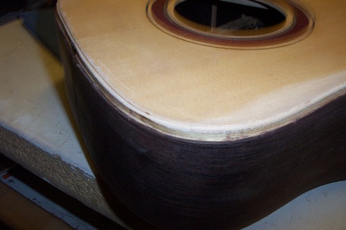

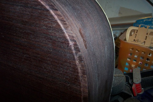

I built mine with a bunch of recycled parts such as bolts, nuts, bearings and metal plates i can adjust for depth of cut, inspired by Arnt's famous jig, it allows me to route free hand while indexing from the sides, the only problem is, i can't draw a plan from parts i only found once and don't know the name of but if it can help anyone, here are a few pics of my thing a ma jigger!!
The results after the first passes
I prefer holding the router than approaching the guitar to it for the router kicks when i start it, i'd rather have it in my hands when it does.

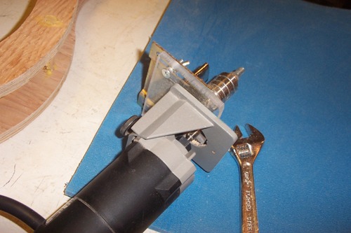

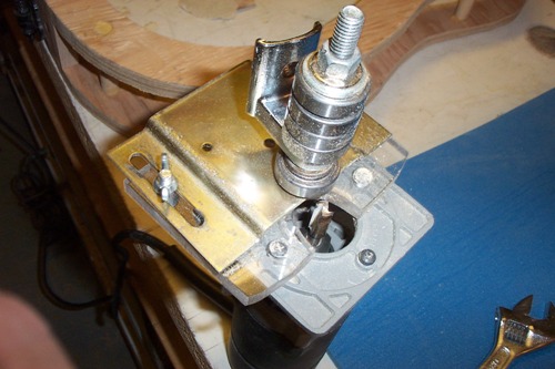

Here are some pics of the tool I made. It is not nuch to look at, but it is sturdy and works .
There is not much to it. I used shoulder bolts and nylon bushings as bearings. It has a nice large surface to rest on. If I where to make it again, I'd get the bearings as close to the cutter as possible. The white disk is Teflon. The clear is polycarbonate (Lexan)
I cut a hole in the back for the router base to fit into, then I lock it down with 4 wood screws with large washers.
Here is John's tool with a spring. It is just an assist so there is not so much force. It is a long spring attached to a shelf above.

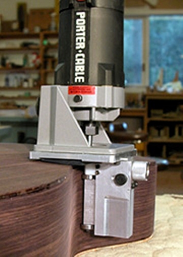

I have gone away from my fixture back to hand held routing using this set up. I had probmes with deep cutaways using my binding fixture. This base and guide system makes hand routing a breeze see it at Luthiertool.com

[QUOTE=MichaelP] I have gone away from my fixture back to hand held routing using this set up. I had probmes with deep cutaways using my binding fixture. This base and guide system makes hand routing a breeze see it at Luthiertool.com
Man! I really like that. any problems/difficulties with that set up? The two handed technique they show in the video looks pretty foolproof. It uses a regular down cut spiral bit right?
PostPosted: Wed Sep 06, 2006 1:24 am
Yep 1/4" spiral down cut is provided with the base. you could use a straight flute cutter but it is set up to work with 1/4". Set up is the same as any roller guide system.
